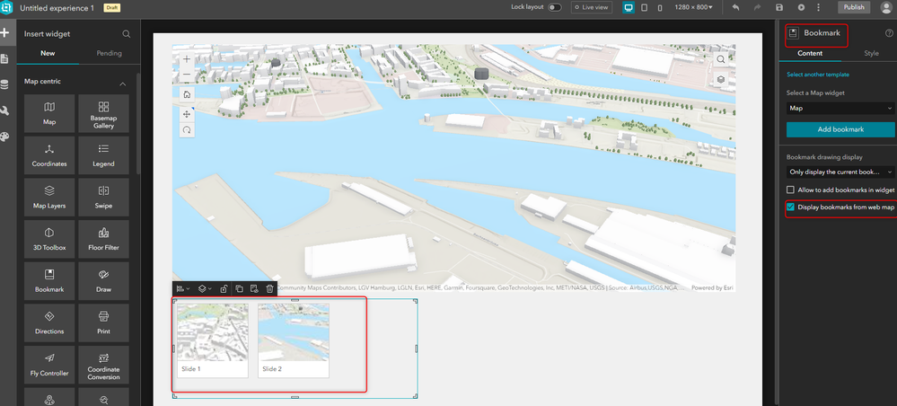

Is there a widget that replicates the "Slides widgets of ArcGIS Web Builder" on the Experience Builder yet? I have a web scene and I want to able to navigate on my 3D map using the captured slides on  Experience Builder any workaround?

You can use the Bookmark widget in Experience Builder to achieve this.
