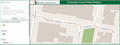

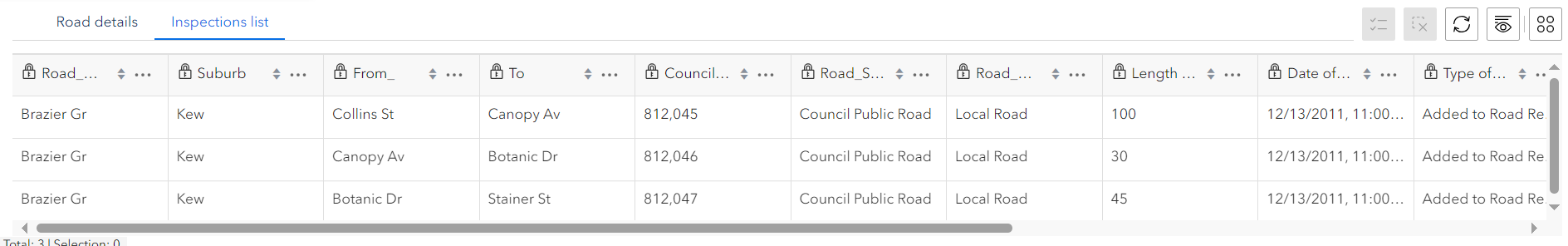

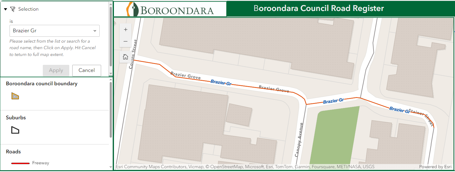

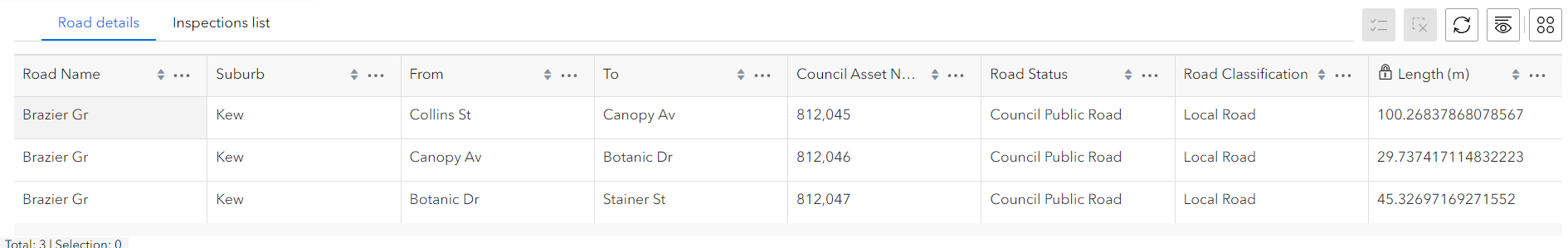

I have created an experience in Experience Builder. The experience uses a filter widget and when executed it zooms into the selected road feature and also filters the 2 tables in the table widget: the feature attribute table and the related inspection report table.
What I would like to do is create a customized report template that will contains the map and the 2 tables. The map and the tables are dynamic in that these change every time a new filter is applied.
I would like also to incorporate report tiles, logos, etc. in the template. Thank you for any help.
Below are examples of the filter output that I would like to be in the report:
