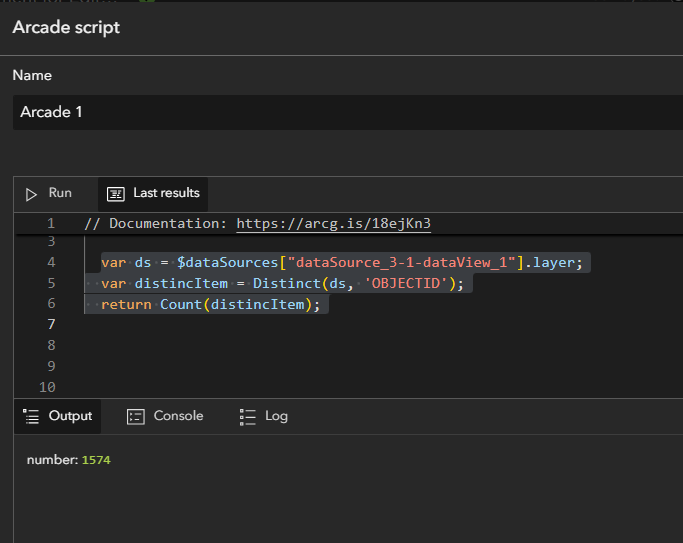

I am looking for a way to implement this code from your link:
var ds = $dataSources["dataSource_id"].layer;
var distincItem = Distinct(ds, 'CNTRY_NAME'); return Count(distincItem);
Could you please explain to me how to add this line  "var ds = $dataSources["dataSource_id"].layer;" from the default function generated in Experience Builder;? How do I find the dataSource_Id?
function getFilteredFeatureSet(ds)
I do not understand how to  type this line $dataSources["dataSource_id"].layer;  in the function generated by Experience Builder.

Found it!
There's no need to declare a function—just typing the code is enough.
var ds = $dataSources["dataSource_3-1-dataView_1"].layer;
 var distincItem = Distinct(ds, 'OBJECTID');
