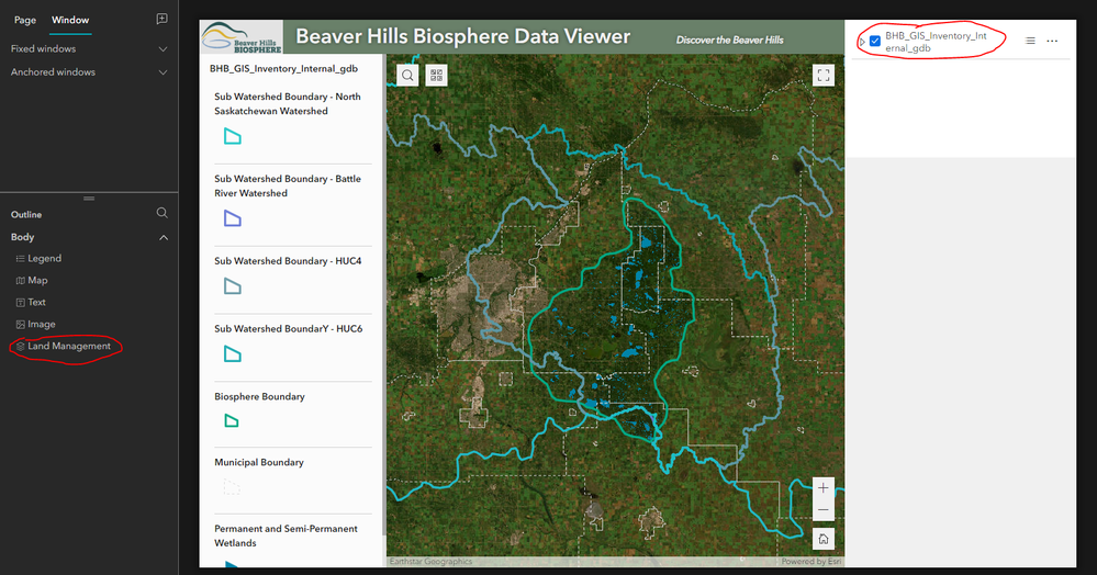

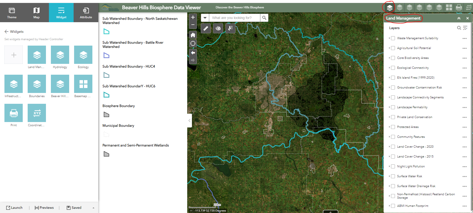

I am currently running into an issue with replicating how I previously had my map layers sorted in our previous Web App. In the original app, I customized layer lists based on the theme of the data - land management, infrastructure, ecology, etc. (see image below for previous Web App):

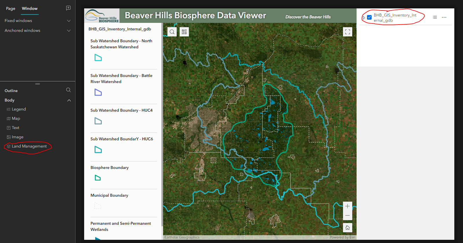

Is it even possible to replicate this containerization in Experience? If not, what is the best alternative? Currently, using Experience I can replicate the custom Map Layers list, but it seems that I am unable to have it as a collapsable widget?
Any and all help/recommendations for how to configure these map layer lists in Experience that would be replicate what we previously had in Web App would be highly appreciated!

https://community.esri.com/t5/experience-builder-tips-and-tricks/five-ways-to-handle-groups-of-layer...
Here is a run down of five different methods for organizing layer groups. Hopefully, one of these will work for you.

@BHB_Admin The Widget Controller widget may fulfill the case of the panel need in WAB.
