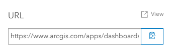

I just had this issue, where I had a multiple dashboards embedded in experience builder, where some dashboards required a log in, and some were just fine. I found that it depends on which link you use for the embed. It seems that when I use the URL that the metadata provides shown below, it causes the issue for users to log in.
Whereas if you use the URL directly from the dashboard page, the login issue disappears. Hope this helps!

ColmOKane
That worked as the url then had the organisation name at the beginning.
