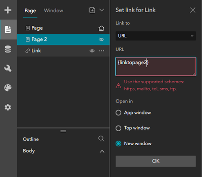

To reload a page inside one app is against our current design. However, you can use an alternative way to achieve what you want - accessing the page using URLs will refresh it.
Adding a link, and linking to your desired page; then hide the original page inside the menu, you may want to change the labels though:

This is so simple and works like a champ! -Thanks
