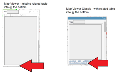

I have a layer with a related table, published from an ArcGIS Server 10.8.1 as a Feature Service and added as a 'Feature Layer' in AGOL.
In the Map Viewer, when I select a point, the popup does not display the related table information. My goal is to use the EDITOR widget in the Experience Builder to add records to the related table.
*** I used the same Web Map in Field Maps, and I am able to view and edit the related table.
*** In Map Viewer Classic, I can see the related table listed in the popup from the layer with the relationship class set up, but this is not the case in the NEW Map Viewer.
Can I achieve the ability to add records to a related table using the Experience Builder Editor Widget AND able to see the related table listed in the popup from the layer with the relationship class set up
