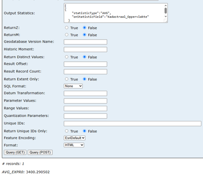

Also having this issue in Enterprise 11.3 with SQL EDGB layers. If this is the bug (BUG-000168610), ESRI is saying it is "as-designed." The additional information makes little sense. Interested if anyone else has found a solution or is still experiencing this.
ThibautDelaere2
I agree, the additional information doesn't make sense. It reads like they found the source, but it's not like a regular user can change the behavior of a default experience functionality...
EDIT: I tried a query without the outStatisticFieldName and it works fine. So this does not seem to be the same bug.
