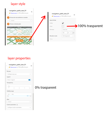

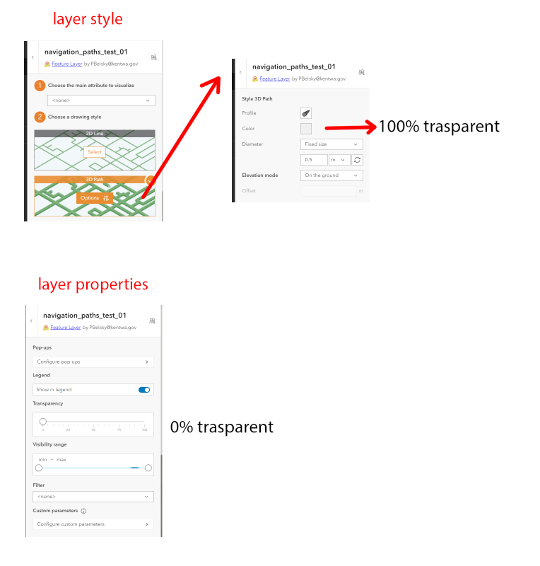

My feature layer is a 3D buffered polyline, laying on a ground (terrain is dissabled).
These are the webscene setting for the layer:

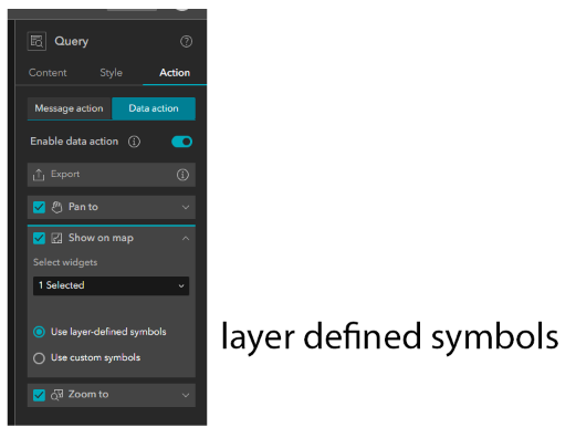

These are the Experience Builder setting for the layer:
I would love to hear your ideas on how to make that work.

The simplest hack I can think of is to make your layer mostly transparent, like 1%. You shouldn't be able to see it, but it should still highlight.
GIS Developer
City of Arlington, Texas
PashaBell
Thanks for replying.
That's the weird part - it highlights as faintly as the layer itself! 🙂 Did you get to play with it too @JeffreyThompson2 ?

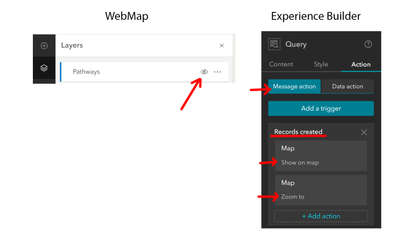

OK, seems like I made it work for now:
on the WebMap side: I have hidden the layer (but it's symbology is exactly how I wanted it to be)
on the Experience Builder side: I have set the trigger settings of the layer to show the resuts on the map - when THE RECORE IS CREATED.
I hope it help anyone else searching for a similar solution 🙂
