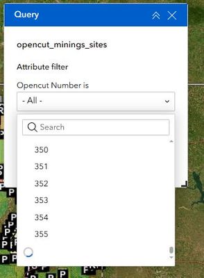

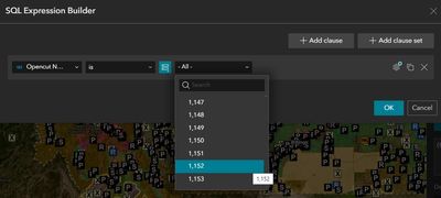

Enterprise 11.3...query widget when being configured i can scroll through all the values...Screenshot 2025-03-10 151313.jpg
Once published it only populates a certain number of values and then spinning wheel appears for anything over the last value...

Hello @Blevins_Mark  are you able to put a more exact figure to "certain number of values" ? Is your data Hosted, or is it Referencing a particular database type ?

hi @Ke_Xu thanks for your response...the issue ended up being the record page size of the layer on the data tab...increasing that from 100 to 5000 (a few hundred more than the record count in my layer) the widget worked as expected. i guess as an enhancement suggestion the default record size should be increased, 100 really isnt that much. thanks.
