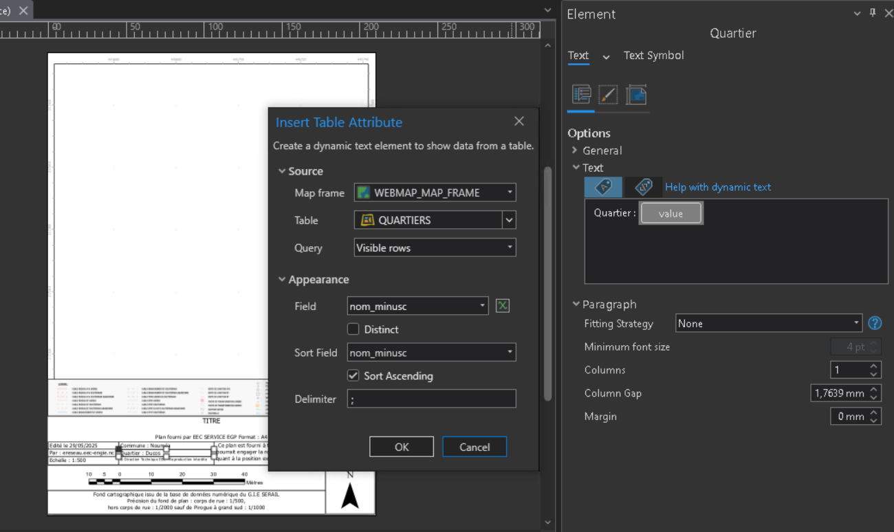

I published a print service with ArcGIS Pro 3.3 with layout templates containing dynamic text from attribute table, as you can see here :
Used in ExB 1.16, it works great and as long as I have the layer QUARTIERS in my webmap, dynamic text is printing in the output.

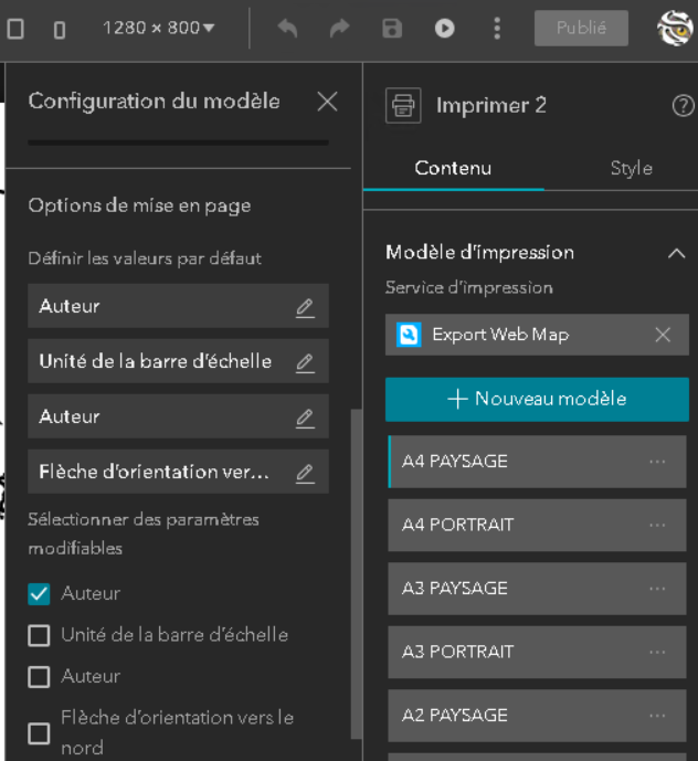

There is no specific parameter in ExB Print widget for each layout template :

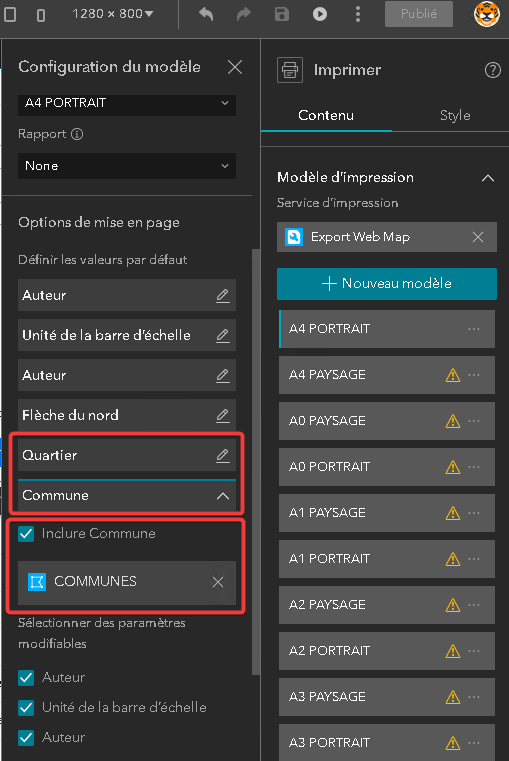

I recently installed ExB v1.17 and noticed some changes, now I need to manually specify the layer from my webmap that will be used in the parameter (ex here with layer COMMUNE)
I tried several different parameters, but none is working. It seems OK in the widget interface, but the printing fails instantaneously, without AGS logs and not even a web request.
Is there something new that need to be done to be able to print dynamic text from table ?

Hi @PierreloupDucroix ,
Does the print only fail when the app is launched? If it works in live view mode, then it's a known bug that will be fixed in the next release.

PierreloupDucroix
MVP Regular Contributor
Hello,
yes, it works in the view mode and fails when the app is launched or published in IIS.
Is there an ETA for next release ?

ShengdiZhang
Hi, a fix will be included in 1.18 next month.
