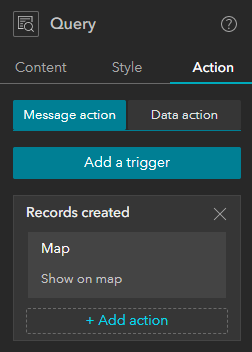

I understand the performance consideration for the single page results only loading one "page" of features initially, but I don't think I'm experiencing the expected behavior of all results eventually being shown if you continue to scroll. In my case it seems like a different 100 records are shown each time, rather than 100 more records being displayed so that after you scroll through enough "pages" all results are shown. Perhaps I've misconfigured my triggers/actions? I followed the Query widget documentation here, so have my trigger on the Query widget as "Records created" with my map as the target and the action being "Show on map", and am using layer-defined symbols:
However, the behavior is that separate sets of 100 records are displayed; I never see all of the records displayed even after scrolling down through all the "pages".

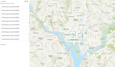

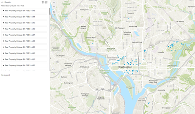

1st 100 records:
2nd 100 records:
3rd 100 records:
etc...
The previous 100 records are not being preserved and added to, but being replaced by the next 100 records. Is this a configuration issue on my end or perhaps a bug that could also be addressed in the next release if this topic is being dealt with?

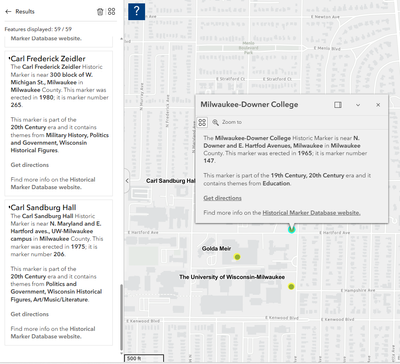

Hi @TianWen,
I am using AGOL ExB - I can't get the query widget to show any more than 10 results in the list? It says 59/59 but the scrolling stops and I only see 10 results. The points are highlighted on the map they just aren't in the list? Is there a new bug in AGOL ExB?
These are alphabetical and I only get to C - I'm looking for one that starts with M. You can see it in the map.
