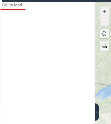

Thank you @Junshan_Liu very much for response. On GUI it shows same message "Fail to load".

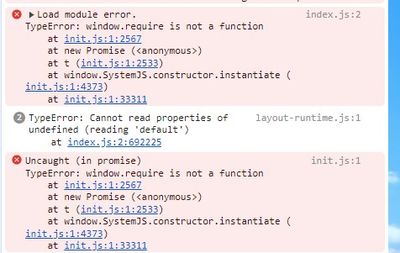

The detailed error is:
Junshan_Liu
Oh, can you add the "dependency": "jimu-arcgis", into the widget manifest.json?
Ming
@Junshan_Liu Thank you so much for your magical power, it works now, cheers!
