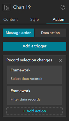

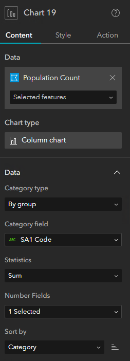

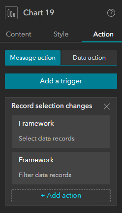

FYI these are the settings on the chart:

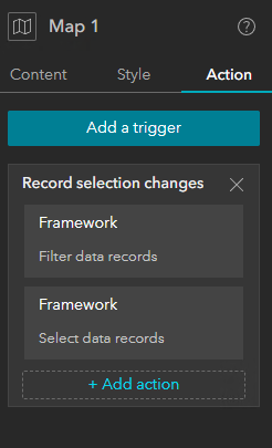

And on the map:

Thanks for your feedback. From my understanding, this previously work fine but a few months ago it shows "No data found", right? And from the screenshot, you do have the "View for empty selection" option checked on, which is correct. Unfortunately, I cannot repro on my side. And the app you attached (https://experience.arcgis.com/experience/401287f49bd84aeb97c438095fe299d0/page/Population-Size/) is not accessible. Would you be able to share this app to me so I can have a further look?
