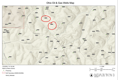

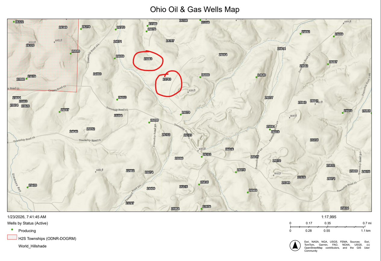

Hello,
We came across an issue recently where our user wanted to print a PDF from the current map extent within an Experience Builder we created. The PDF that was produced showed labels for layers that were turned off in the map. Another issue is the user was at an extent where the labels were not turned on (if they zoomed in further, the labels would be visible) and when they printed the map, the labels were visible in the PDF (which was not what they wanted).

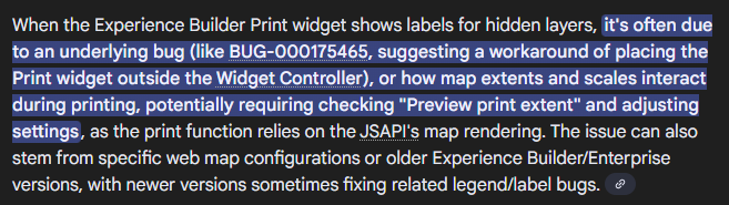

Has anyone come across these issues? It seems like a bug. I did find something on if the print widget is nested in a widget controller if can cause these issues. I deleted the print widget and removed it from the widget controller and the issue persisted.
Below is an example of what I'm talking about. I circled a few of the labels that should not be there (they belong to a layer that is turned off) for reference.

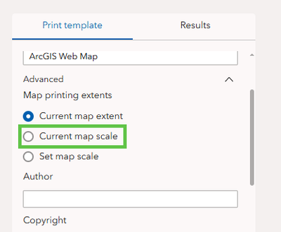

Hi @KatiePhillips_ODNR ,
When printing with the current map extent, the print scale differs from the map scale, and labels may be visible.
Could you reproduce this bug if choosing "Current Map Scale" for the map printing extents?
