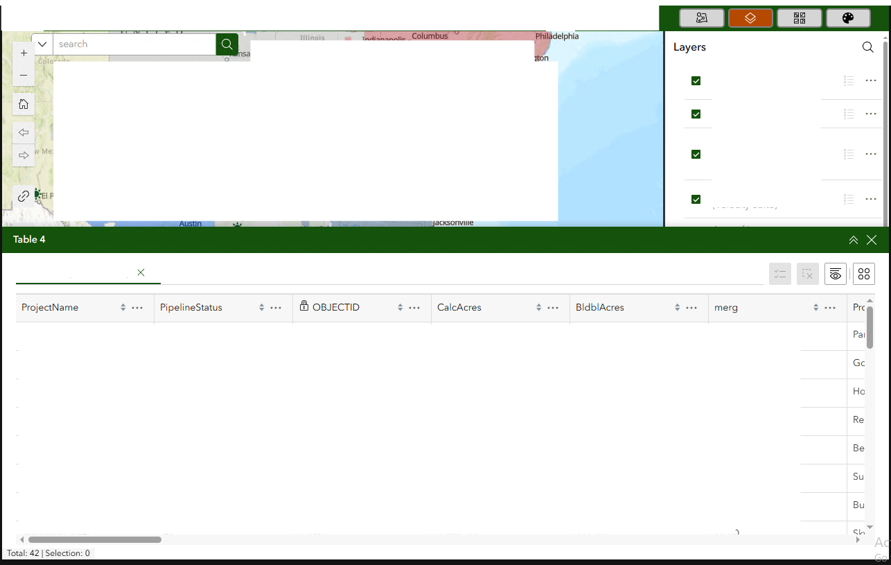

I do have one remaining challenge. I was trying to keep the Attribute Table inside a sidebar so it wouldn’t overlap the Layer List. When I use the widget normally, the Attribute Table opens as a floating panel and ends up overlapping the Layer List, which is located in a different sidebar.
Is there a way to keep the Attribute Table contained within a sidebar (similar to Web AppBuilder) so it doesn’t cover other tools? Snapshots are attached

You can place the Table Widget within a Sidebar (instead of a Widget Controller), but the auto-opening behavior will not work in that configuration.

Thank you! Yes, this is how I have it.
