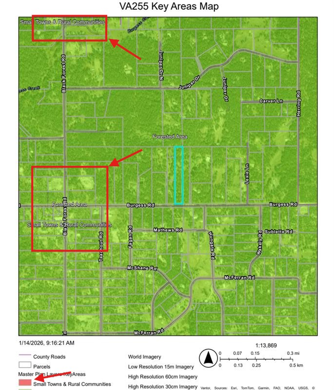

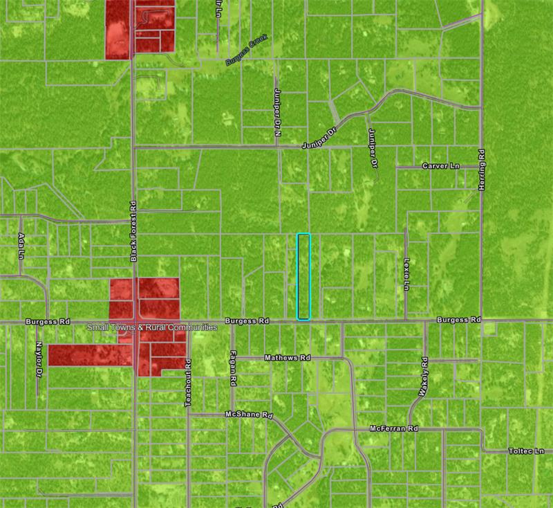

The issue does not appear to be related to scale or layer visibilty, as the layer is present in the printed output but does not render as it should. In the screenshots, the green and red symbology in the first image belong to the same layer. The difference in color represents two overlapping features, which is why we are using the "display features by value order" setting.
It works correctly in the web map and within Experience Builder when viewing, but when printed, the vallue based drawing order is not honored, and only one of the symbology values from that layer is displayed in the printout.

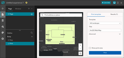

I just tried and it worked for me. I also tested it from both AGOL and Enterprise server. If you still have some issues, it'd be very helpful if you could share something with us to try, or reach out to Esri Support. Thank you!
ExB app

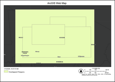

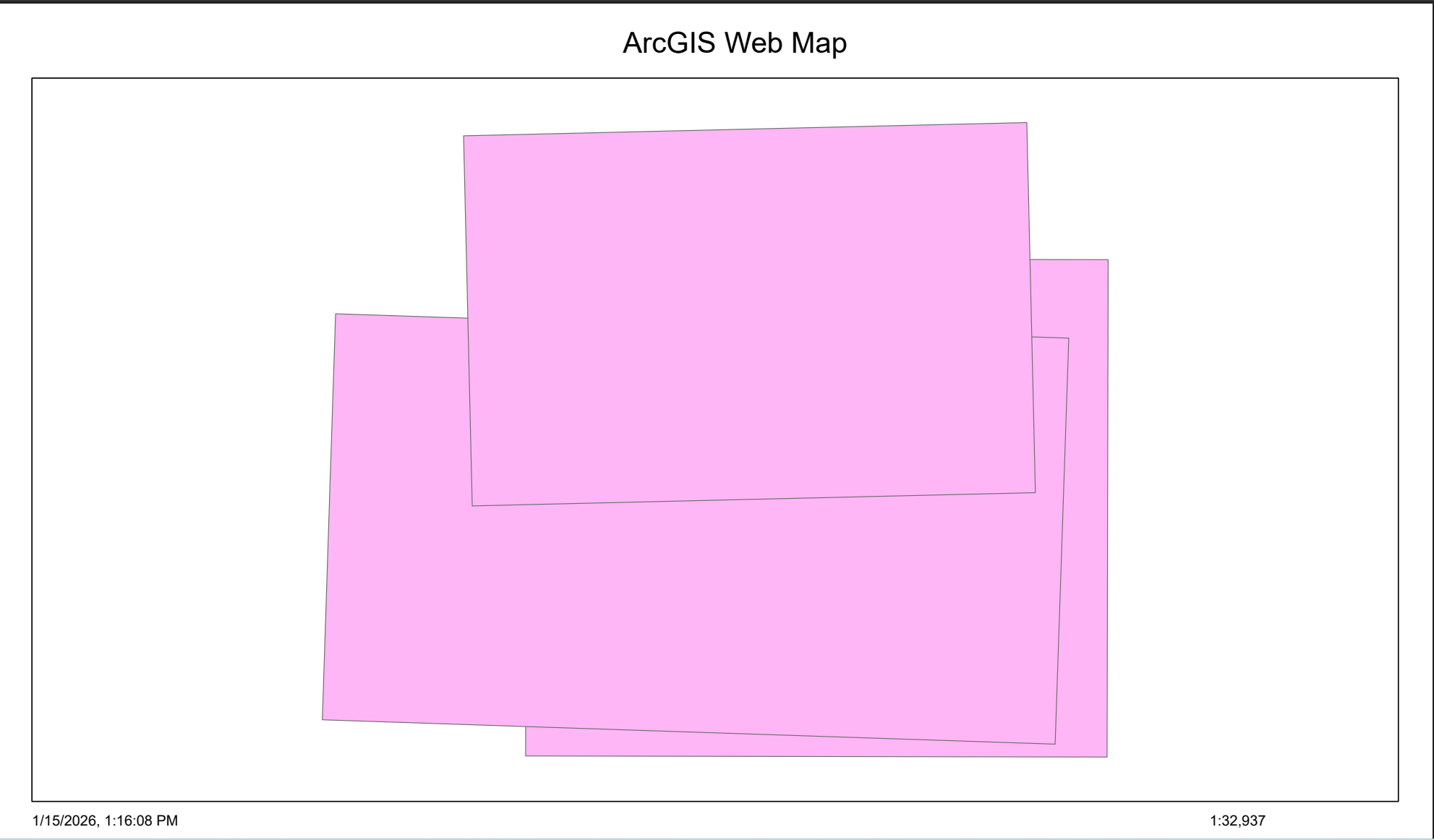

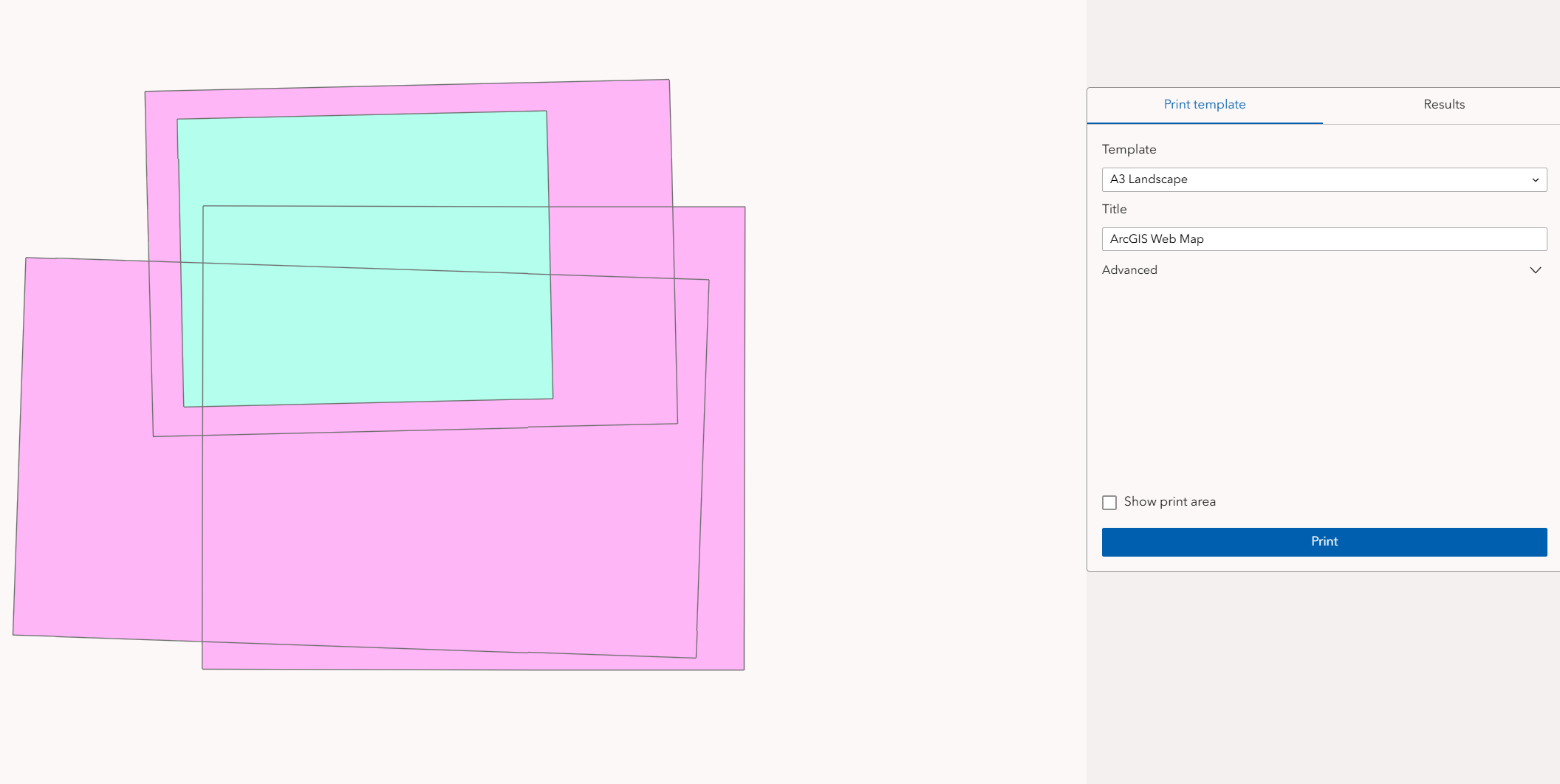

I'd be curious to know whether assigning a unique attribute to those overlapping polygons so that one polygon beneath the other is symbolized with a different color, and then using "Display features by value order" in the web map would result in the same printing behavior. I put together a quick example for screenshots.  Hopefully it helps clarify.
Screenshots:
  1. Web Map drawing order setting - enabling the "display features by value order" option controls the drawing order, allowing the teal colored feature to display above, despite the feature being beneath the others.
  2. Web Map Drawing order setting enabled
  3. Experience Builder Map View - The map renders properly in Experience Builder, with the value drawing order enabled and the teal feature displaying as it should.
  4. Experience Builder Print output - when exporting the map using the Print widget, the value based drawing order is not respected, and the teal feature does not appear on the printout.
