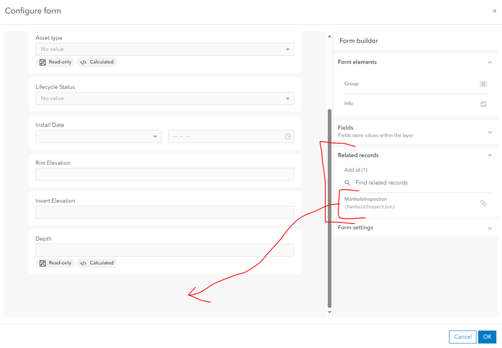

Hi @aawadrsk ,
Thank you for posting! You've completed almost all the steps for editing your related records, there's only one left: you need to configure the Forms.
You can do this in Map Viewer: Configure forms for attribute editing (Map Viewer)—ArcGIS Online Help | Documentation
When you'll configure the Form for your parent layer, you'll be able to add the related record element to it, which will allow users to add a related record after a feature was created in the parent layer.
The Forms you configure for your layers in Map Viewer will be reflected in the Edit widget in Experience Builder.

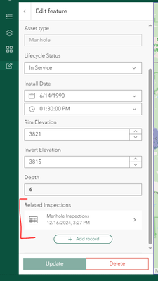

aawadrsk
Hi @AlixVezina
Thank you so much for your guidance! Configuring the forms in Map Viewer worked perfectly, and I’m now able to access and edit related table records in Experience Builder. It’s a great improvement to have this functionality!
