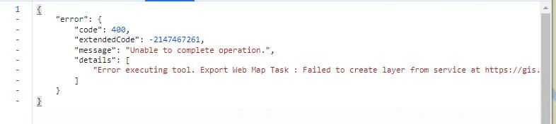

New to Experience Builder and I'm having an issue with the print widget involving one specific layer. I'm working with Portal v11.1 and when I attempt to print the map when a specific layer is turned on, the print task fails:
The layer in question was shared from its SDE location (not hosted in Portal) and the Portal sharing is with our organization. If I don't include this specific layer, the print map operation completes successfully. The layer draws in the map without any issues.
Anyone seen this before?

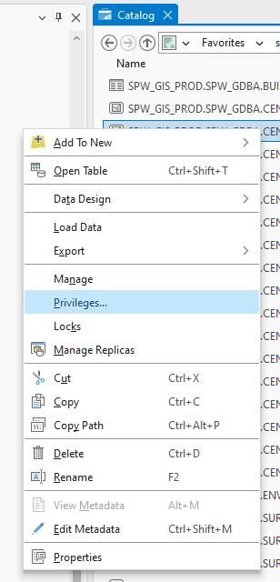

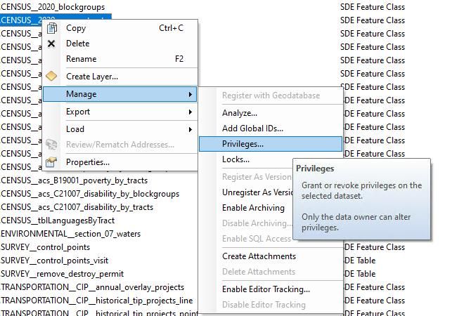

Yeah, this setting is accessed by right-clicking on the SDE layer in ArcCatalog or Catalog View/Pane in ArcGIS Pro:
ArcCatalog:
ArcGIS Pro Catalog View/Pane:
