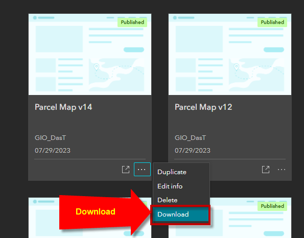

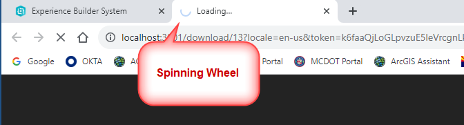

You may have run into this issue where you are attempting to Download a ZIP file of your Experience Builder Developer Project.

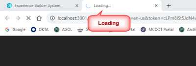

The download process spawns a Loading Page with a spinning wheel.

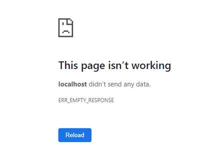

After waiting for a while, you get this error message:

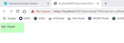

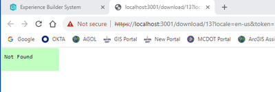

So you attempt to Download the ZIP file a second time.
You get this new error message:
Not Found
How do you proceed?

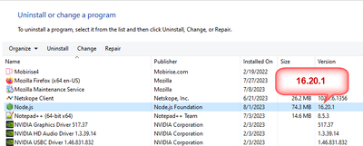

In my previous post I presented a possible workaround on using EXB 1.12 with Node.js 14.21.3.
I looked at the ESRI documentation and found that Node.js version 16.20.1 is recommended.

Downloaded Node.js version 16.20.1 (Gallium) from:
https://nodejs.org/en/download/releases
Selected Releases for Node.js 16.20.1 Gallium.
https://nodejs.org/download/release/v16.20.1/
Downloaded the file:
Node-v16.20.1-x64.msi
Installed Node.js 16.20.1

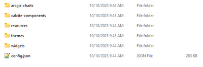

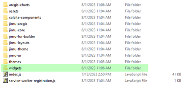

The themes folder was created.
Then the widgets folder was created.

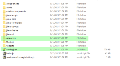

C:\DAVID\EXB\EXB13\server\temp\13\cdn\1
Finally, the resources folder got created followed by the all-important config.json file.
Essentially, all the necessary files were written at this point.
The ZIP file should have been created and the process should have stopped.
However, the process hung.
I received this error message.
Not found

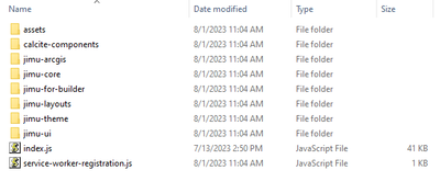

Most of the files and folders started to get deleted.
I was left with only these.
This means upgrading Node.js from 14.21.3 (Fermium) to Node.js 16.20.1 (Gallium) did not resolve the issue with downloading ZIP files.
The workaround is to monitor the server\temp folder and stop the process as soon as it finishes writing the widgets folder and manually assemble the missing files as I have explained in my previous post.

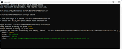

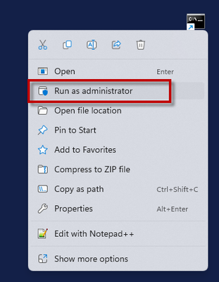

I had not experienced this problem until today. Then, I realized I was not running my terminal in admin mode. When I restarted my server with my terminal in admin load. It downloaded without issue.
Attempting to download in regular mode produces the following terminal error:

I opened a Command Window as Administrator and started the npm server process.
When I attempted to download the ZIP File, I got this error message:
Not Found

For those who are concerned about having to "manually reassemble" files as noted in the PDF, I've found that if I end the process once the json is written, there's nothing missing for me.  The app works when uploaded for me at that point.
