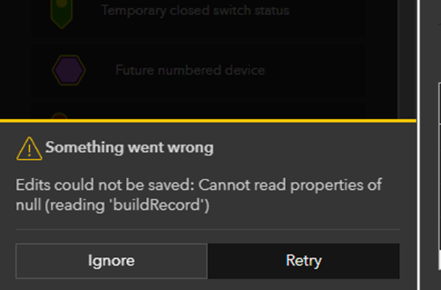

I am just starting to use Experience Builder to create a data editing interface (would have preferred WAB but I have been using advance symbologies in the New Map Viewer that is not supported in WAB).
The editing was working ok a couple of weeks ago, but now we get this error when adding new points.
Edits could not be saved: Cannot read properties of null (reading 'buildRecord')
Based on the error message, I would guess that maybe some of fields are not nullable and having no input data is causing the error. But I checked all of fields and everything is nullable except for the GUID & OBJECTID.
Has anyone else had the same issue and able to troubleshoot?
Update: I also get the same error message when I delete a record (which did not happen previously).
It is looking like a bug in Experience Builder as if I edit the layer in Map Viewer, I do not get the error message.

I also encountered this error at one time when using the editor widget in Experience Builder. I found when I went to check the editor widget there were several layers with errors in them, likely from changing the schema around after the Experience was published. Once I removed the layers and re-added them, the error icons went away, as well as this error message when trying to add and delete features.
Hope this helps.

Ramon_de_Leon
Thanks Calvin, that seems to solve the problem. Glad that the solution is simple.
The only difference between your experience and mine is that I did not change anything with the schema or changed anything related to the experience (map and feature layers). I noticed though based n your suggestion of removing/adding the layers, that my layers had a warning sign that says the data is inaccessible.  Another thing is before fixing it, if we did press the "Ignore" on the error message it does create/delete the data, and "Retry" would be an endless loop of the error message.
