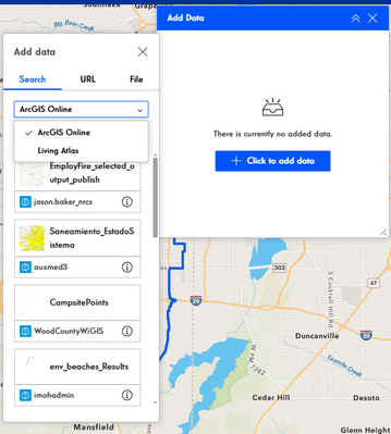

  • The OOTB Add Data Widget could not access any information from the Enterprise Portal. It could still access ArcGIS Online.

Issue 1: The props.user value is null and the Add Data Widget cannot communicate with the Enterprise Portal.
