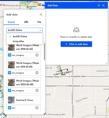

  • The OOTB Add Data Widget could not access any information from the Enterprise Portal. It could still access ArcGIS Online.

I'm running into the same issue with a similar setup. We are using ArcGIS Enterprise 11.1 with IWA enabled and have an experience built in version 1.16 deployed to our web adaptor servers. The first time a user browses to the application, everything seem to work accordingly. After some time or a cache clear, the ability to search our enterprise using the Add Data tool goes away as well as other functionality such as the related data action and the elevation profile tool. The attached picture is the request and response sent after opening the Add Data tool.
Has there been any progress on this issue?

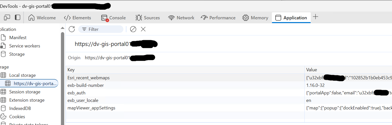

Thanks for your feedback! We save the token in local/session storage, I believe this is caused by the saved token is expired. Could you check the following when you see the issue next time?
* Open browser developer tool
* Open Application tab
* In the Local/Session storage, find "exb_auth" key, check whether the token is expired
BenFerguson
Thank you for responding.  I did some more testing and when it is successful, there is an entry for "exb_auth", when it is not successful, there is no "exb_auth" key at all.  The pertinent data is visible in "Esri_recent_webmaps" however.
But your question led me to look at the fact that I had not registered this app with Portal.  This app was copied from another computer.  Once I did register the application, it seems to be working properly now.
