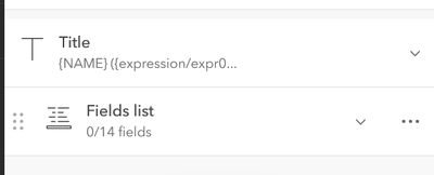

Just to check, are you editing the pop up within the pop up tab in the web map viewer?
I assume your configuration looks similar to the above screenshot with all fields removed and just the title present? Could you confirm that once you save this web map and navigate to experience builder, the pop ups appear differently than within your web map?

Hello - I've had this issue too (although in a web scene) but I found a workaround so thought I would post it.
In the 'configure pop-ups' window, deleting the 'fields list' item would result in this issue.
Instead if you keep the 'fields list' item and instead remove all of the fields so it is empty, then the pop-up will display without the list.

Just replying to this as it is still an issue 2 years later! I used @KatieSelfEd 's suggestion and kept the field list but unticked the boxes and that does the trick, but surely that isn't how it's meant to work? @IssyAmis is this being looked at at all please?
