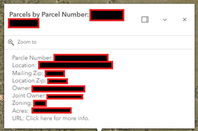

This question stems from this Esri Community post. The post linked tends to relate to the search widget within the map widget and not the search widget itself. I have a series of map services within a web map that I will use in the search widget (not the Search radio button on the map widget). When a user searches one of the layers, the result they select should have a pop-up equal to how it is set in the web map such as below.

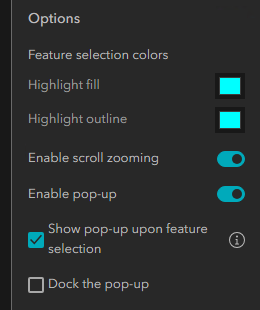

- Enabled/configured pop-ups in web map.
- Enabled pop-up upon feature selection on the web map in Experience Builder Developer.

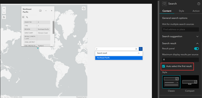

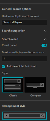

Have you tried to turn on the "Auto Select the First Result" in Search widget?

Hi @Ke_Xu, yes, the Auto select the first result was enabled in the Search widget.

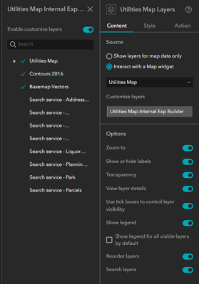

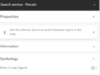

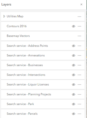

@Ke_Xu, I think I found the missing step. Originally, I was trying to correlate a search web map with a separate web map that I was using in the Map Widget. After adding the search layers to the map that is being used in the Map Widget, I was able to construct the steps in Experience Builder to get the pop-up to show the item being searched.
1. Add search layers to the web map, and turn off visibility.
2. Turn off the show in the map legend.

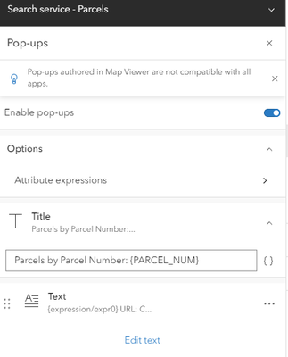

3. Enable and configure pop-ups.

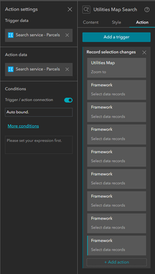

4. In Experience Builder Developer Edition, add the search layer as a new search source from the layer source.
5. Under the Action tab, if needed add a newly added source to Zoom and/or Pan trigger.
6. Add action and framework,  Select Data Records, and Select newly added search layer as Trigger data and Action data.
7. If needed in Layer List, uncheck the newly added search layer so it is not visible.

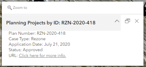

Search for a parcel number, map will zoom to and open a pop-up,
