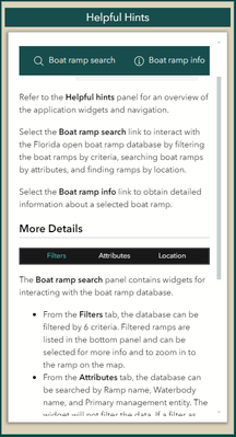

Just wanted to pass this along in case anyone found it useful, but my solution to this was to create a new widget for the sole purpose of adding html to a fixed panel. This way I can do whatever I want and it actually took less time than fighting with the Text widget to get it to do something it wasn't designed to do.
I did this in about a day and a half:
I have two scroll bars (vertical and horizontal) that act independently of each other, the vertical scroll is hidden when the mouse is over the image so you can scroll horizontally without the parent div moving.
Here is the code:

    return (content)
FranklinAlexander
Here is the code:
