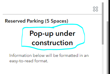

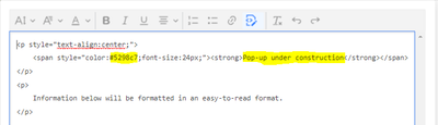

It appears text colors include in a pop-up, are ignored by the Feature Info widget.
Map Viewer:
Pop-up Source:
Experience Builder:
Text colors are not being inherited by the Feature Info widget

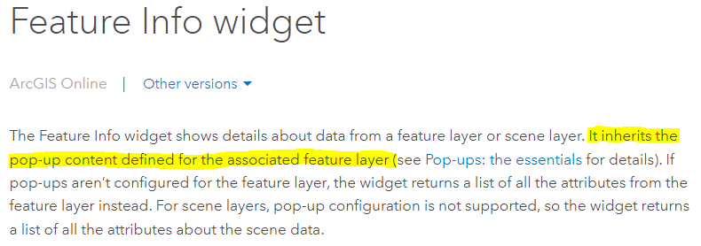

Feature Widget documentation:

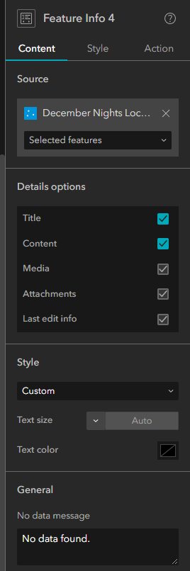

How do I configure the pop-up to be inherited by the Feature Info Widget?
rVeloz
under the Style option, have you tried changing to Respect the source instead of Custom?
9 Replies
rVeloz
RyanBohan
Thanks @RVelez,
That did it, Thank you.  Why is "Respect the source" not the default?
