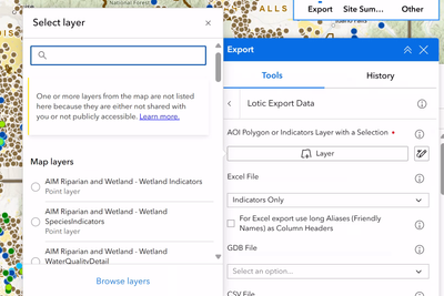

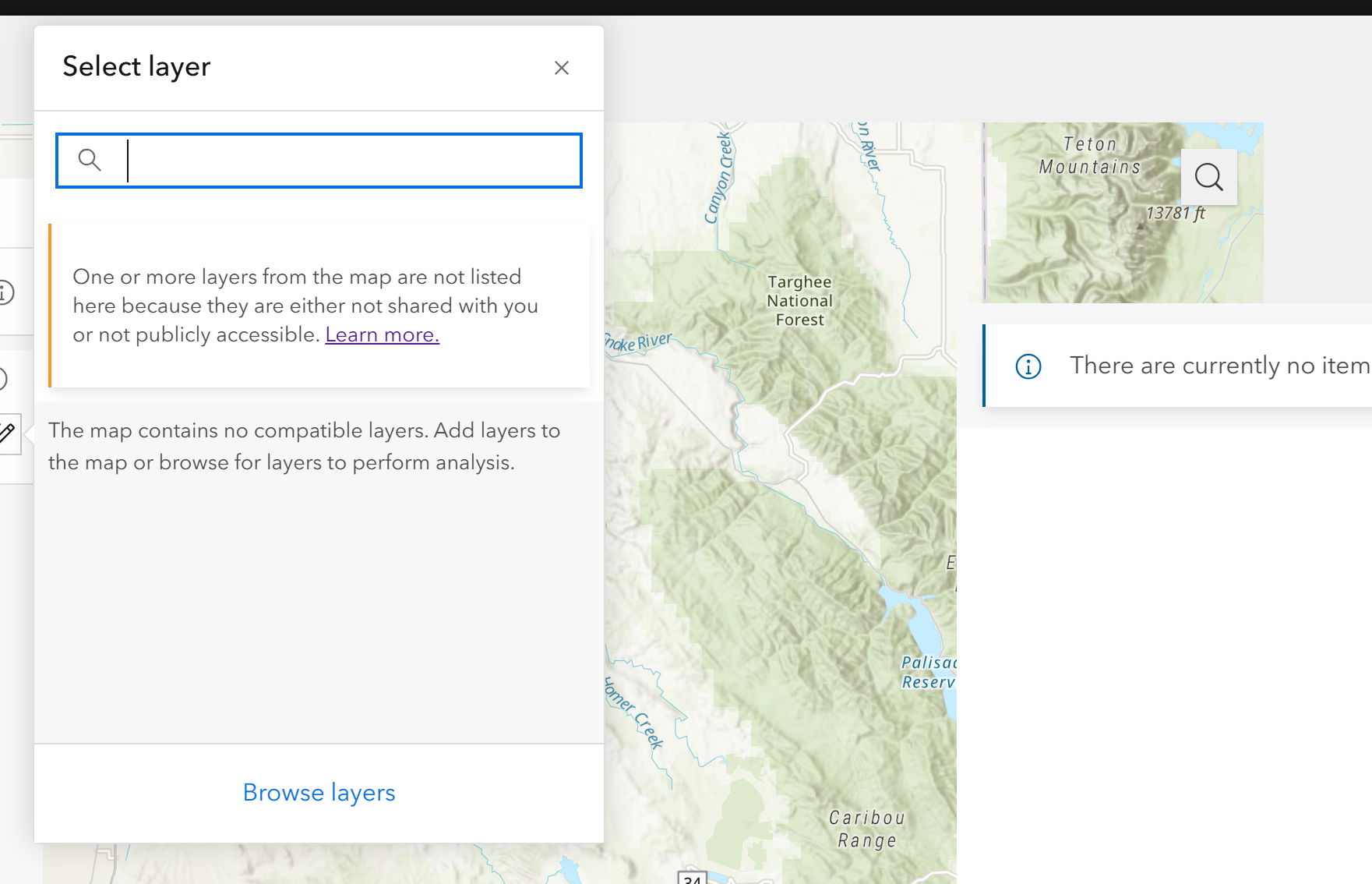

We have been getting this message for months.  I took each layer out one by one until I had a completely empty map and I still get this message.  Not sure what public has to do with anything really.
What is going on here and how can I get rid of this?
thanks

I think I traced this down to it blocking ALL non public layers from being inputs.  I could maybe see this for online analysis tools but we are using custom geoprocessing tools hosted on our own servers.  So these should be able to use our own internal layers just fine.
If I use Set as Analysis input from the layer it is hiding on me it works just fine.
This seems like a hardcoded bug?
thanks

I could share the app but not the layers.  But its an easy one to see and it happens in all ExB we have ever built.  So nothing to do with ours specifically.  It is AGOL ExB.  Basically the Analysis widget is blocking ALL non public layers from being used.  It does not seem to check which tool it is.
The tools are our own custom geoprocessing services running on ArcServer 11.3.  They are not AGOL.  So that means the layers do not need to be public for the gp tool to work.  I can see why they would need to be public for AGOL geoprocessing tools.  But internal there is no reason to block this list.  I think this is simply a hardcoded in block where they forgot that geoprocessing services can be custom and thus the layer would not need to be public.  I think its just an oversight and easy fix.
If you go through the Set as Analysis Input button off the popup these tools work just fine.  So again no need to block them from the list.
