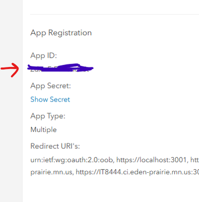

Yeah there's a way! First, go into the app you have registered in your Portal/AGOL and find the AppID:

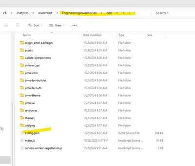

Then, after you download the app data and have hosted it on your server, open the app's cdn folder and find the config.json:
From there, search for 'ClientID' and add the app ID into that parameter
