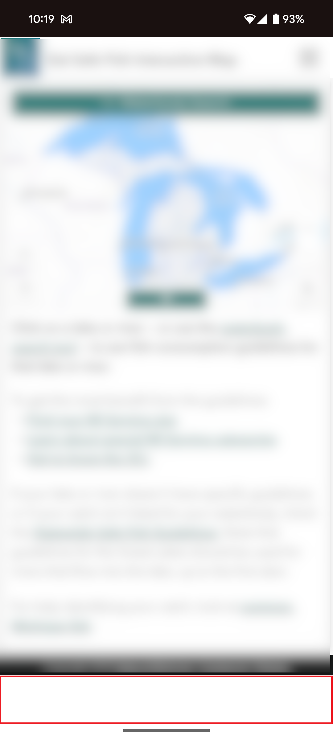

I'm using ArcGIS Online and viewing my experience on a Pixel 8a (Android) phone using Chrome. I'm curious if other people have experienced this.
My experience has an intro page that scrolls. The next page is a static page. Unfortunately, going between the two types of pages causes this blank area to appear at the bottom of the static page:

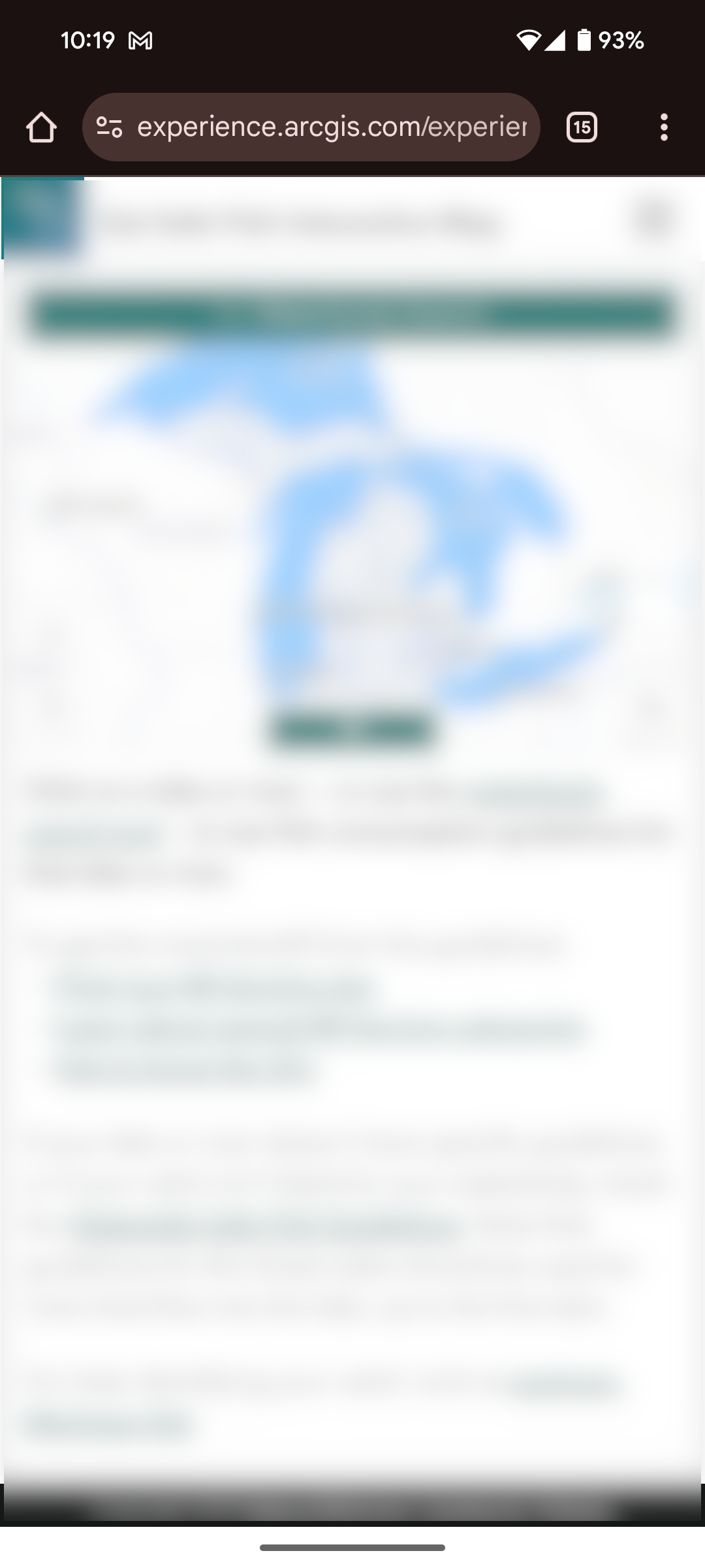

I can "pull" the page down and it looks as intended, and I get my address bar back:
Even if I don't pull the page down, everything still works as intended, it just doesn't look very professional.

Thanks for sharing the details. I tried setting up a scrolling page and a static page like you described, and switched between them, but I wasn’t able to reproduce the issue on my devices (both Android and iPhone).
If possible, it would be really helpful if you could share a sample app (shareable) or setup where the issue happens—that would make it easier for us to look into the cause.

Sorry, just saw this! I would love to share the app via a group. Is "zhenzhang" the right AGOL username?
I have since tried the app on a Pixel 5a and a Galaxy S23+, and both show the issue. Everything looks exactly as intended though on my coworkers' iPhones.

Thanks for your sharing. This seems to happen because when you scroll up, the browser hides the address bar and toolbar. If you switch to a full-screen page while they’re hidden, the space they usually take up stays empty at the bottom. Once you scroll down and the address bar shows again, the page layout goes back to normal.
On iPhones, the address bar doesn’t hide the same way, so the issue doesn’t appear. So the extra space at the bottom is related to how mobile browsers handle the address bar during scrolling.
