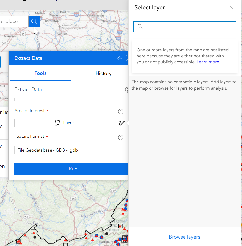

I configured a custom web tool called "Extract Data" in the Analysis Widget (Experience Builder 1.17). The required parameter, 'area of interest,' allows users to browse layers within the organization and draw layers on the map. However, it does not permit assigning default layer from the displayed web map.
How can I configure it to use a default clip layer from the map?

From the Analysis widget it does not support to set default value of a tool.
But if it is a custom web tool, when publishing the gp service from Pro, it should allow to remember the default value or even always use default value.
