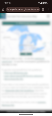

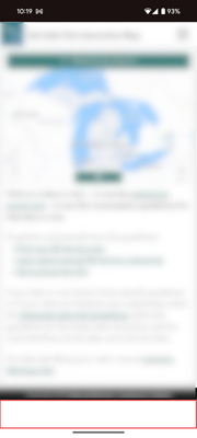

My experience has an intro page that scrolls. The next page is a static page. Unfortunately, going between the two types of pages causes this blank area to appear at the bottom of the static page:
I can "pull" the page down and it looks as intended, and I get my address bar back:
Even if I don't pull the page down, everything still works as intended, it just doesn't look very professional.

Hi Nicole,
Thanks for your sharing. This seems to happen because when you scroll up, the browser hides the address bar and toolbar. If you switch to a full-screen page while they’re hidden, the space they usually take up stays empty at the bottom. Once you scroll down and the address bar shows again, the page layout goes back to normal.
On iPhones, the address bar doesn’t hide the same way, so the issue doesn’t appear. So the extra space at the bottom is related to how mobile browsers handle the address bar during scrolling.
