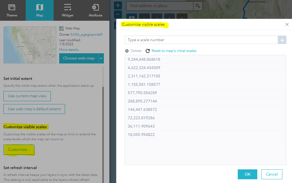

In ArcGIS Web App Builder under the "Map" feature, one could restrict the zoom levels by selecting Customize... under the section "Customize visible scales" and then remove unwanted scales:
I could not find that feature in Experience Builder.  Does it exist?  If not could you please add it to the Roadmap, please?
