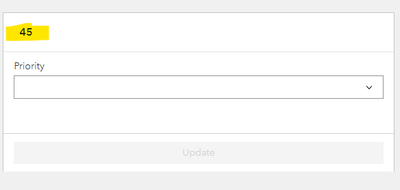

I'm wondering if there is a way to change the field that is automatically chosen as the display field on the Edit Widget under "attributes only"
More specifically, I don't want the OBJECTID field to be shown, as this number is irrelevant to staff using the tool:
The data being referenced in the edit widget already doesn't use OBJECTID as its display field, and is not referenced in the pop-up either.
Any ideas?
I'm using Enterprise 11.1
