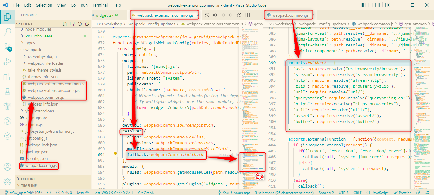

So far so good. Except that this configuration has been chopped up in ExB and spread over several files:
From left to right:
  • webpack.config.js in the "client" root folder referencing webpack-extensions.config.js in the "webpack" subfolder.
  • webpack-extensions.config.js builds the config from references to webpack-extensions.common.js
  • in webpack-extensions.common.js the resolve object occurs in 3 places, namely in getTemplatesWebpackConfig(), getWidgetsWebpackConfig() and getThemesWebpackConfig(). Here the property fallback is entered, whose contents (analogous to the other props) are entered in webpack.common.js.
  • finally in webpack.common.js the references to the polyfilled packages are under exports.fallback.
That works.

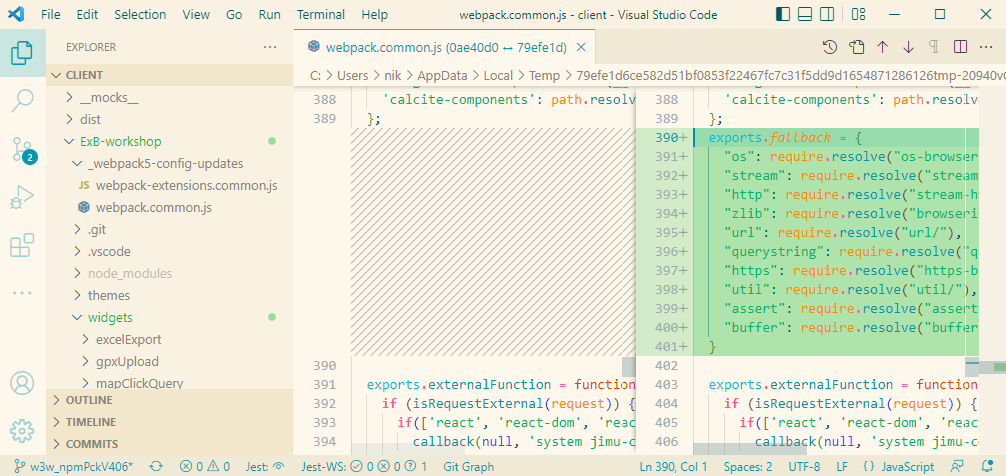

The trouble is, that the webpack files on root level of the "client" folder are not in my "exb-web-extension-repo", but are delivered with the ExB. Now if you use NPM packages in your custom widgets that require polyfills, you have to get to the webpack configs, but they are not in the repo. -_-
My solution: In my repository I created a subfolder called "_webpack5-config-updates", which contained the original supplied configs as the first commit. In the second commit are then my additions, so that one can also still understand, what has changed.
This becomes important when you include several repos, each of which needs its own polyfills. Because then you have to look at the configs manually and add all needed polyfills to the webpack-configs in the "client"-folder.
