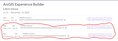

I will do that, thanks. Out of curiosity, what are the other two downloads for? I've actually downloaded them once before when on the phone with an analyst, but we both weren't sure what they did.

I did a new install of ExB v. 1.13. I can confirm that the package-lock.json file (along with many others that weren't there before) is now in the client folder. I ran npm ci from the admin prompt. New errors:

JeffreyThompson2
MVP Frequent Contributor
The node cache are all dependencies that you are trying to install with npm ci. They are provided so you could potentially do an offline installation.
I think the other package is just a copy of the Experience Builder documentation website.
