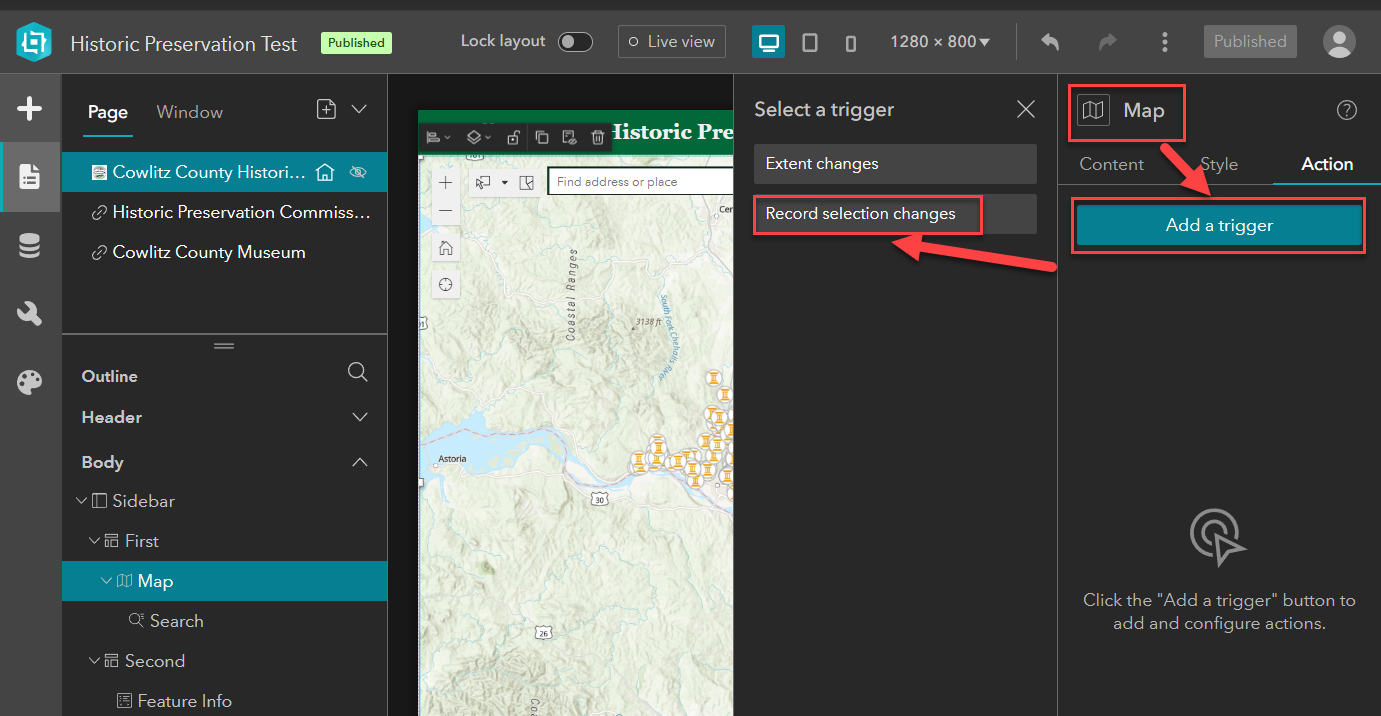

This is my first time using Experience Builder and I am stuck on this step:
On the map section I clicked:
Add a trigger
Record Selection Changes
(and want to add an action of zoom to selected, but I can't figure it out)

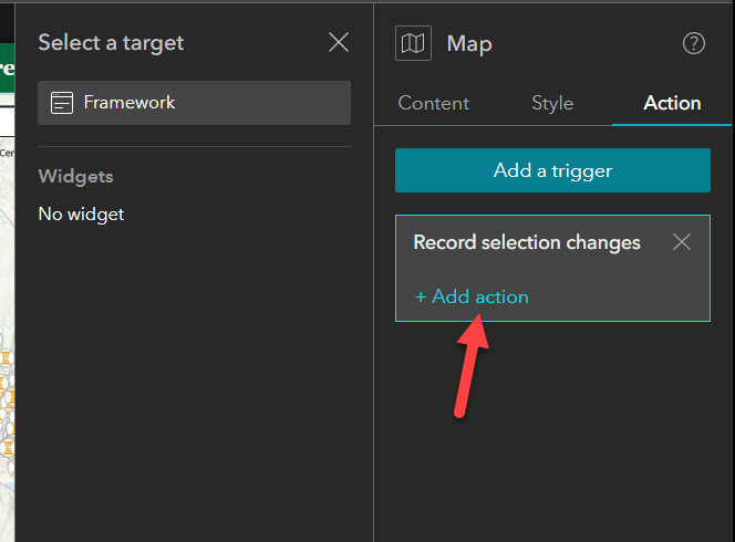

I click Add Action and select a target pops up on the left but I don't see an option for zoom to selected.
9 Replies
TonghuiMing
Hi @L77, if you want to zoom to the selection, the map widget is not the trigger (but rather the action part). Thus, you should configure the trigger inside whichever widget you want to actually trigger the map zoom, such as a List widget (when you make the selection), instead of within the Map.

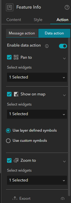

For my layout I have a map and a feature info widget:
I have it configured so when someone clicks on a point the data for the point shows up in the feature info box.
I set a trigger on the feature info widget to:
pan to 1 Selected
show on map 1 Selected
Zoom to 1 Selected
But when I click on a point on the map it doesn't zoom to the point.

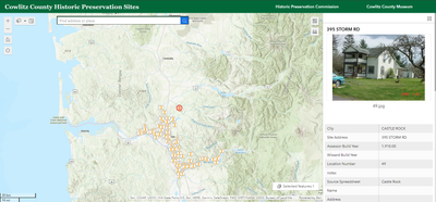

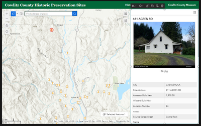

I also tried selecting a point but it won't zoom to it automatically when I select the point:
