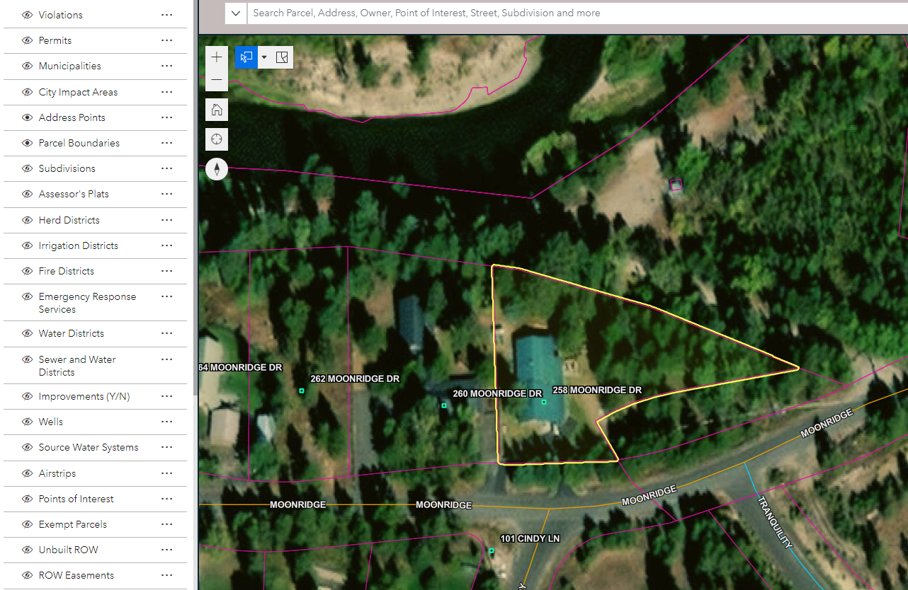

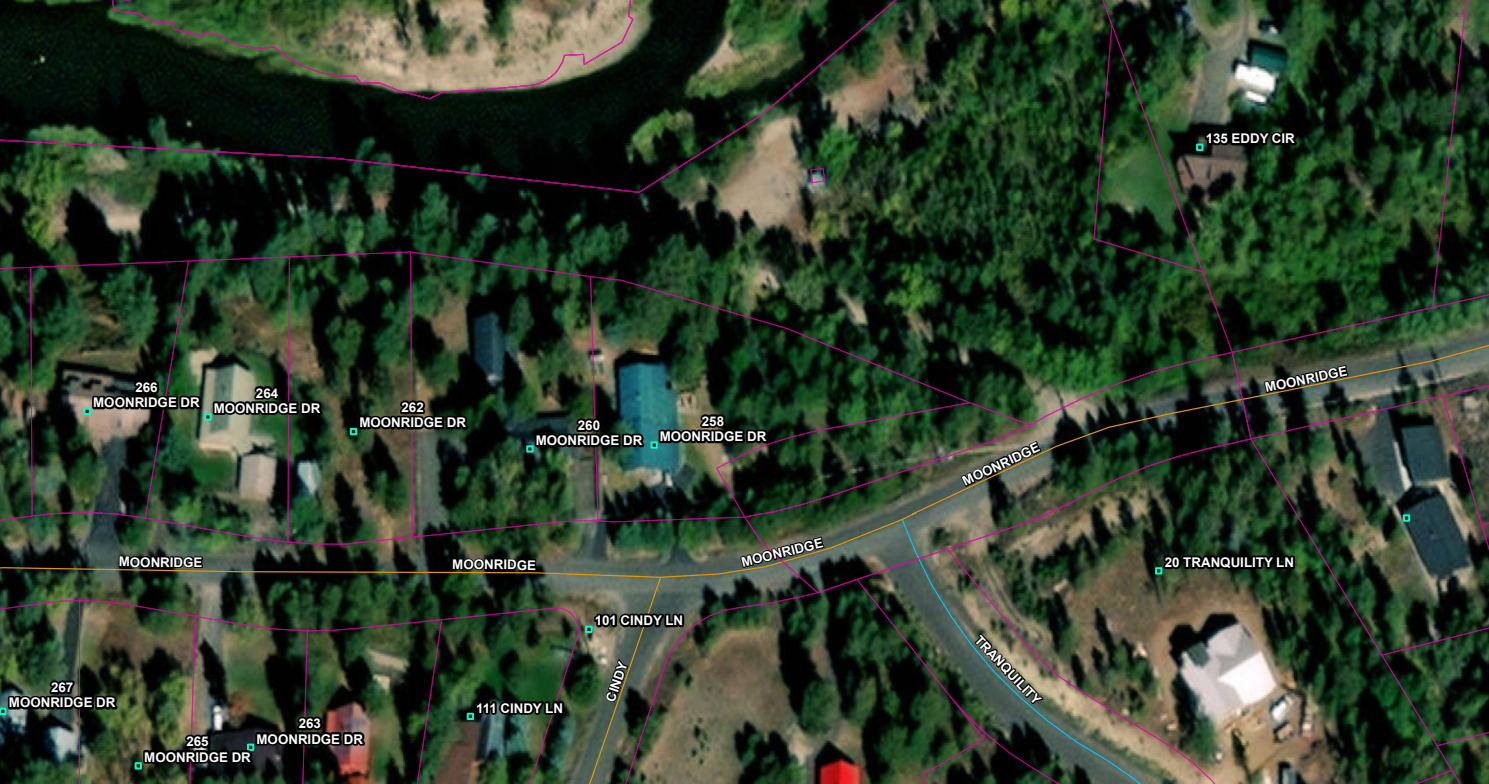

The print widget won't show the selected features from the map in the image it creates which is an essential part to cartographically calling attention to what you want the recipient of the map to see. This was available in WAB and was always useful - is this a bug in the print widget in EB?

For your first question, currently it is a known limitation that the print service cannot print highlight features, please refer to https://developers.arcgis.com/javascript/latest/api-reference/esri-rest-print.html

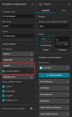

And for the second question, if you want to include the legend by default, you can check the "Include legend" option in Template configuration - Layout options - Set defaults:
