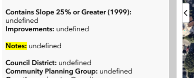

I just tested the "Feature Info" widget with a Feature Set in a Web Map.
My layer has multiple Arcade expressions for popup window.
Some use "FeatureSetByName by $map".
The result of these expressions is not visible in the Web Experience. But it is visible in the Map Viewer.
Is there a bug or any Arcade functions do not work yet ?

If I am seeing right, some of the expression are displayed but some are not?
Those expression 11-17 with $map are all not displayed. Am I right?
MatthiasDufour
Hi
Thank you for your answer.
It's exact.
Only expressions with $Map do not work.
