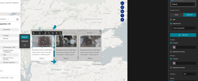

You can do this by creating a list, with cards, and have the card image as a direct link to an attachment or a field.
OSADICKB
Thanks so much Jonathan. This is super! Changing the paging style arrangement then allows me to switch from scroll view to page view, which addresses my issue of having users flip through individual photos related to the same attribute.

Are you able to share more specifics on the solution to this?  I'm having trouble figuring out how to do this based on the response you received.  I only see a picture but no explanation on how to do this.
