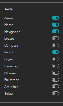

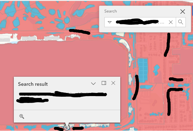

So in Experience Builder, the user has the ability to turn on the search option/tool on the map (not talking about the search widget). This search tool is linked to a geocoder(s). Currently when you search for an address it zooms to a scale shown below in the screenshot.
Now my question is, is there a way to modify the zoom level when using this search in Experience Builder?
Current output:

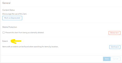

It turns you can actually edit the Zoom level of the map search tool in Experience Builder which is actually tied to the extent set in Map Viewer. This can be done by changing the extent box size under item details page settings.
