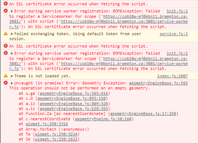

I tried troubleshooting by looking at my console in Chrome, but didn't really find many threads on fixing the errors that were logged (see attached screenshot). The first two service worker errors occur even when the widget is working correctly, so I assume those are not critical, while the last geometry exception error only occurs when the widget stops working so I think that is the root of my problems.
I am running ExB Developer Edition, but am trying this with just the default unmodified Near Me widget rather than the one I modified the assets/code for to eliminate the possibility that my customization is the cause of this issue.

The error seems to indicate that Near Me is trying to run a calculation on a missing geometry. Can you verify that all of the data sources are working properly? Does the error occur as soon as the page loads? If so, there is likely an issue with a React component loading before getting the data it requires.

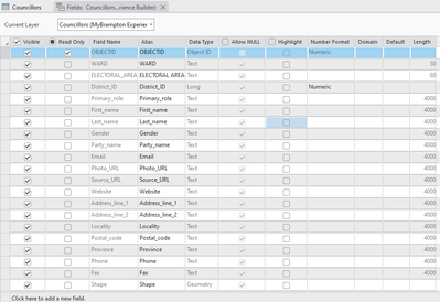

There's a lot of feature layers being used, but I think I've narrowed down the problematic layer to one. Unfortunately that layer isn't available publicly, but it's a simple join of a layer with a table on where the "District_name" field in the table is used to join onto the "WARD" field of the polygon layer. The polygon layer and the table are both available to the public, and the URLs are provided below:
Polygon Layer: https://www.arcgis.com/home/item.html?id=61b3e12fb4d74d078a15512dc3baf568
Table: https://www.arcgis.com/home/item.html?id=699654b8f595400db0d8ae82b2108e92

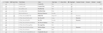

ruikaitang_brampton
In that case I think the join I performed already copied the data from the both source layers into it's own new layer, and doesn't have the issue you are describing. You can see my fields for the layer of interest in the screenshot below.
