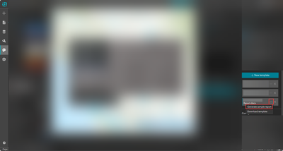

Andrew_McLellan
Hey, @rwygmans@HBrowning
I found your post and was asking the same question. It's hidden in the newly saved template section for some reason.
Select a feature in your map while in "live mode" in experience builder. Then click the three-dots button next to your report template and it will give you an option to generate a sample report.
HBrowning
Oh my gosh, amazing! Thank you Andrew!! 🙂
