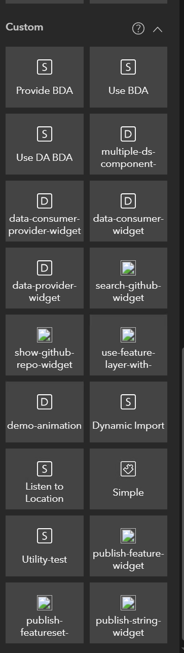

Hi Everyone,
We've been looking into developing some custom widgets in ExB and have noticed that there already appear to be a lot of them available that we didn't create:
I can see these custom widgets in 11.1 on a couple of different portals, but not on a few 11.2 portals.

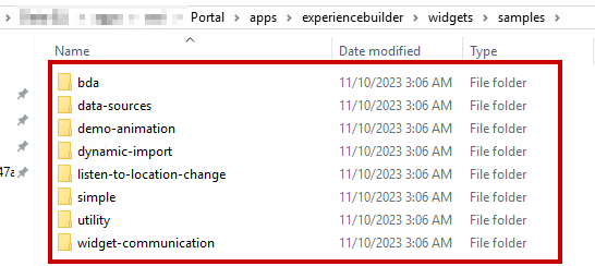

They appear to be available in the "samples" folder within the deployed version of ExB at this version:
Ideally we'd not want these widgets to be shown in the builder, only the custom widgets we develop.
Does anyone know what these widgets are? Is there a "developer" option I've switched on by mistake somewhere perhaps?

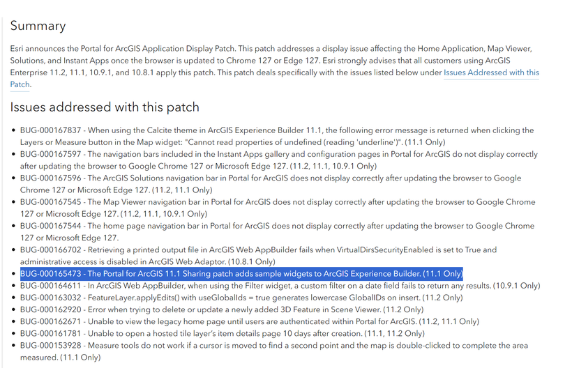

Hi Jason,
Perhaps that's an Admin/Standard user permission that's showing difference between users. It did end up being resolved with the Application Display Patch on our side:
If you're able to get that installed it should remove the sample widgets from ExB.

Hi Jason,
