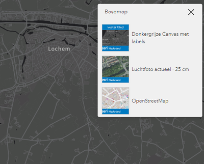

Yes of course. All screenshots are taken at approximately the same time.
Here is the basemap selector in the ArcGIS Online experience.
Here is the basemap selector in a hosted Experience on our server made using ArcGIS Experience Developer edition.

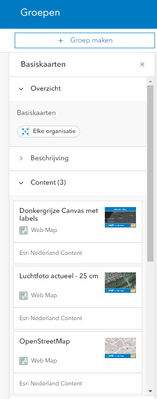

And this is the group for the basemap gallery of our organisation.

Here you go. It should be synced, but it does not.

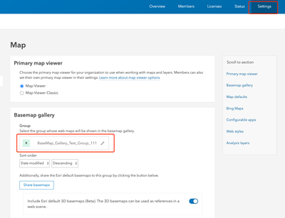

Are you sure that the basemap group configured in the organization is the group containing three basemaps in your screenshot?
NielsPerfectPlace
I'm very sure. It was the first thing I checked.
