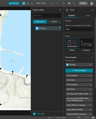

2) What printing service are you using? - out of the box or custom?
3) Not sure why this would matter but what co-ordinate system is your data published in?
mattmerc
Wow! Thanks for looking into this @gis_KIWI4 .
1. AGO
2. Standard OOTB ExB print widget. NOTE: I am using a custom symbol
