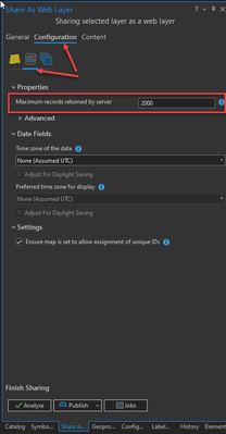

2000 is the hardcoded limit. I put in 40000 as a random large number. There is no workaround for this that I'm aware of.

This is because when the layer was published it was set to allow max of 2000 records.  When you share as web layer you can change this here:
