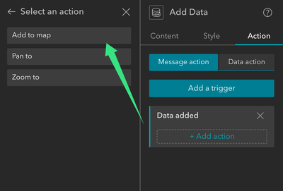

Hi @JustinWade , the map widget can only uses map data source, I assume your output data source is a feature layer.

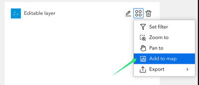

To add the layer data source to map widget, you can use the DataActionList  component to add it to the map in the runtime (need the end users to click the 'Add to map' button, please see add data widget).
If you want to add the layer automatically as soon as it is created. Try the message actions. Add '"publishMessages": ["DATA_SOURCES_CHANGE"]' to your widget's manifest.json and publish the message when your layer data source is created. Please note, the builder users need to configure the message action before publishing the app.
const dataSourcesChangeMessage = new DataSourcesChangeMessage(widgetId, DataSourcesChangeType.Create, dataSources)
MessageManager.getInstance().publishMessage(dataSourcesChangeMessage)
