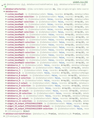

Thanks to your suggestions I have a block of code that completes without error and the DataSourceManager indicates that the layers have been accepted as valid datasources. However, the Select Widget still does not acknowledge them and the full list of data actions is not visible.
mapLayer = new FeatureLayer({
				url: layerGroup.layers[i].url,
setTimeout(() => {
				console.log(mapLayer.sourceJSON)
				const data: DataSourceJson = {
					id: 'custom_' + layerGroup.layers[i].id,
					itemId: layerGroup.layers[i].id,
					type: 'FEATURE_LAYER',
					geometryType: mapLayer.sourceJSON["geometryType"],
					label: mapLayer.title
				const dataJson = Immutable(data)
				const dataSourceOptions = {
					layer: mapLayer,
					dataSourceJson: dataJson
				console.log(dataSourceOptions)
				const dataSource = DataSourceManager.getInstance().createDataSource(dataSourceOptions)
				dataSource.then((source) => {
					//map layers widget
					const messageLayer = new DataSourcesChangeMessage('widget_30', DataSourcesChangeType.Create, [source])
					MessageManager.getInstance().publishMessage(messageLayer)
					//select widget
					const message = new DataSourcesChangeMessage('widget_63', DataSourcesChangeType.Create, [source])
					MessageManager.getInstance().publishMessage(message)
				console.log(DataSourceManager.getInstance())
}, 3000)
Console log of DataSourceManager.GetInstance()
The only actions I am getting are the same ones I saw adding the layers to the map using the JS SDK methods.
I have added the publishMessgaes statement to my manifest.json.
  "name": "add-remove-layers",
  "type": "widget",
  "version": "1.11.0",
  "dependency":  ["jimu-arcgis"],
  "exbVersion": "1.11.0",
  "author": "Jeffrey Thompson",
  "description": "Loads or removes sets of data by groups or individual layers",
  "copyright": "City of Arlington",
  "license": "",
  "properties": {},
  "translatedLocales": [
    "en"
  "defaultSize": {
    "width": 800,
    "height": 500
  "publishMessages":  ["DATA_SOURCES_CHANGE"]
What am I missing? @YueyangLi @Wei_Ying @TonghuiMing

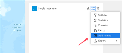

The DataSourcesChange is a message action, that must be configured in the widget settings (builder).
If you want an action to add the new layer data source to the map widget in runtime, you can use the DataActionList component like AddData widget. The select widget can use the new layer data source after doing that. The component will calculate the supported data actions based on the added widgets and show a dropdown list.
I'm glad you have found a workaround. But if you want to use the DataActionList and have other issues, you can reply there.

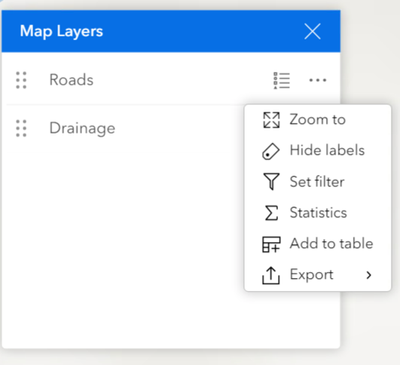

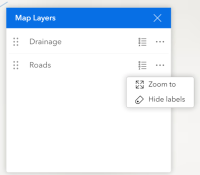

MohammedHilal_K
hi @YueyangLi
I followed your suggestion and it is working fine. I could able to get the data actions like zoom to , pan to etc. But the thing is I need to reorder the layer, the polygon has to go bottom and point on top and line on bottom. When I reorder  he layer using view.map.reorder(), am losing the data actions. any help on that?
QunSun
by Esri Contributor
Hi @MohammedHilal_K ,
Are there any errors in the browser console? Which data actions are missing? Is it only zoom to and pan to that are missing, or are they all missing? It would be great if you could upload a screenshot of the data actions.
MohammedHilal_K
Hi @QunSun
Am attaching the screenshots. Only zoom to/hide label data action is available after reordering the layers.
Before re-order
after re-order.
