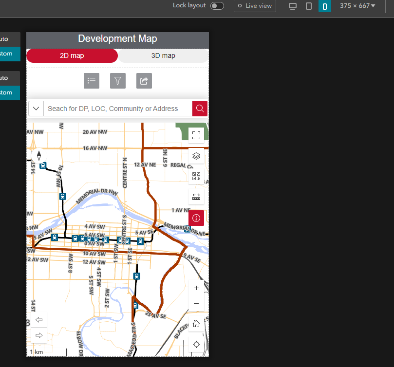

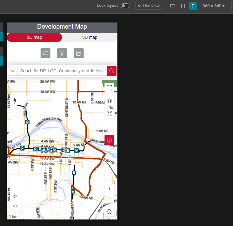

I am curious if this was by design? When configuring my mobile experience I toggle the "Locate" button on the Map Widget. However, as a best practice I tend to make my custom layout to operate with the smallest stock size. In doing so, I am unable to display / fit the Locate button if my Map Widget is smaller than 600px.
The next screen size allows for the Locate to display.
What are my options here?

I appreciate your input, the layout was determined months ago and there is no desire to alter it at this time.  What I ultimately would like to have the capability to have is the same experience that Instant apps has with a position manager for the map widget. Hopefully, this can be realized in the future. For now the Full Screen widget solve my issue.

Hi @TonghuiMing, I'm also wondering about this. The Locate button does not appear on my small-ish phone screen even when making the map as large as possible (header on top and 40-px view navigation on bottom). Is this enhancement still being considered?

Hi All,
This issue will be resolved on ArcGIS Online in February 2026.
The map tools will only hide when there is insufficient space within the Map widget.
For example, if only the Locate tool is enabled, the tool will remain visible as the size of the Map widget changes and will only hide when the widget no longer has enough space to display it. The Fullscreen, Search, Layers and Locate tools are the last to disappear.
